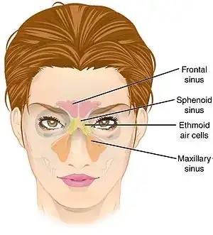

Consider the illustrative case of the paranasal sinuses.
https://en.wikipedia.org/wiki/Paranasal_sinuses
The paranasal sinuses have a wide variety of functions including lightening the weight of the head.
https://www.ncbi.nlm.nih.gov/books/NBK532926/
Incorporating large air filled spaces within a structure allows a large structure of lighter weight.
So too your giants! Most of their apparent bulk is full of air sacs. Birds take advantage of this same principle and at the same time augment their respiratory ability.
https://birdsupplies.com/pages/your-parrots-respiratory-system
Being composed mostly of air would let your giant easily reach your desired size, while at the same time weighing about the same or even less than a normal human. The giants would probably want to stay indoors during windy days.
