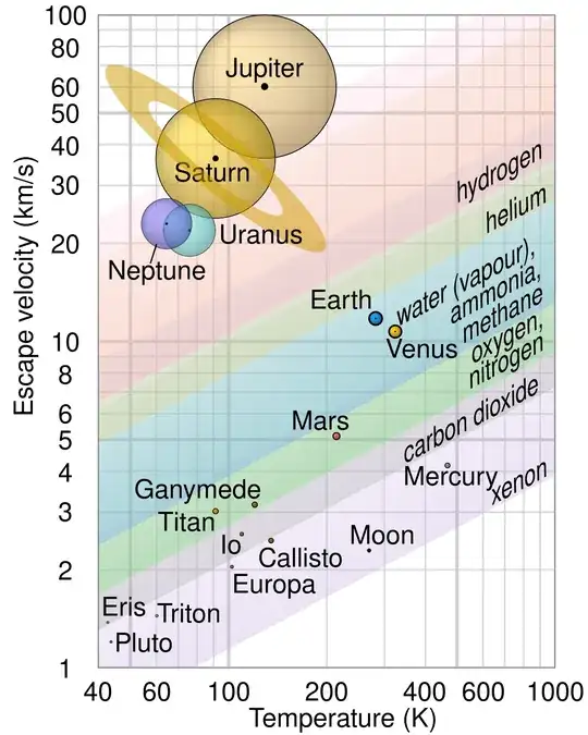

However, there is an issue I see concerning the Max_Max case. It is called atmospheric escape and can ruin your day during planet formation. You can see that whether or not a gas will remain in the planet's atmosphere depends on the escape velocity given by
$$v_{esc} = \sqrt{\frac{M}{R}}$$
and the temperature of a planet is given by
$$T_{eq} = T_{star}*(1-Ab) ^\frac{1}{4}*\sqrt{\frac{R}{2a}}$$
$Ab = \text{albedo}$
$a = \text{distance}$
From this I get $v_{esc}$ of 15.34 km/s for the Max_Max scenario, which gets awfully close to the point where it retains helium and would turn into an ice or gas-giant.
Atmospheric Escape Graph from Wikipedia
Atmospheric escape is the make it or break it point in the end for the survival of an Earth-like biosphere. You need methane, ammonia and water to stay on the planet and you need helium and hydrogen to leave. Otherwise it is utterly impossible for an earth-like biosphere to be sustained.
