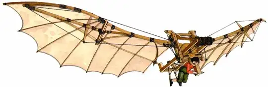

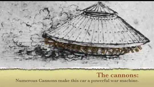

Leonardo was massively ahead of his time, but most of his inventions were impractical for the period because there was no compact power source available. His clockwork powered "car" does work as advertised, but modern replicas only go about 40 metres before the springs unwind. The team of men cranking away on his "tank" can move modern replicas over flat, firmly packed ground, but there is no possible way it could actually move cross country. The flying machines could possibly work as gliders with the wings outstretched, but no human could ever pump the mechanism fast or hard enough for the flapping motion to make it fly.

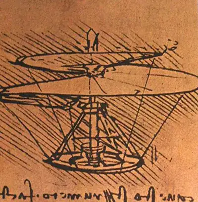

If Leonardo were to consider how to harness the energy from the jack to turn the airscrew of the helicopter, there is a (very low) probability that he might generate enough lift to at least hover briefly. Even assuming complete success, Leonardo's helicopter has no real means of control, and likely would be unflyable.
The most probable means of success would be to have some sort of clutching mechanism, and spin the airscrew up to speed by an external mechanism, such as a team of horses pulling a rope wrapped around the axle of the airscrew. Once aloft, the pilot engages the clutch and the "jack" keeps the airscrew spinning quickly enough for a relatively controlled descent. The device might "jump" into the air to the height of a low tower (3 or possibly 4 stories) then spin down to earth at a relatively slow speed (enough to walk away from).
Sadly, this story would likely repeat from the Renaissance to the late industrial age (like it did in our time line; the first successful helicopter flights took place just before WWII. Even autogyros did not fly until the 1920's, and they are far easier to create since the rotor freewheels and has no thrust delivered to it).
So Leonardo could put in heroic efforts, but end up with an entertaining toy for the Duke d'Sforza. With the technological base of the 1500's, that is about all that would be possible.

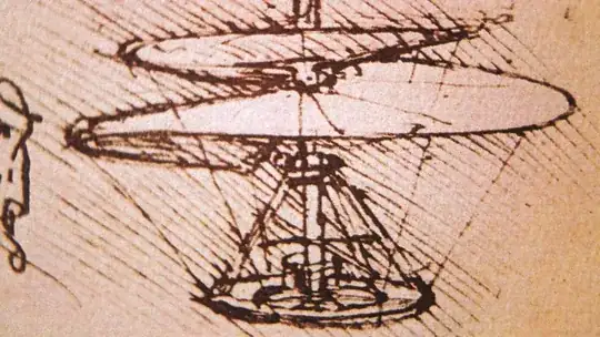

Leonardo da Vince, rather famously, sketched out the design for a mock helicopter.
I'm not saying this specific design would work, I'm saying that the Renaissance definitely had people with the knowledge and the drive to make such helicopter if they felt like it. The math required isn't complex The main problem is that you specified steampunk, which, while a fantastic genre, uses steam powered engines. And those are heavy. Really heavy. To the point where they wouldn't work.
