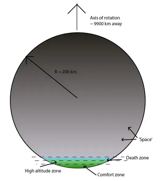

I think there is a very serious problem with the practicality of your environment. If I understand your description, you have a torus with major radius 10,000 km and minor radius 200 km, spinning fast enough to produce approximately 1/3g centrifugal 'gravity' within the volume of the torus.
But then you want approximately 1 atmosphere pressure inside the torus. The atmosphere will be driven to the outer radius of the torus in the in the same way as our atmosphere is attracted to the surface by earth's gravity. This will result in a pressure differential with height similar to that seen on our atmosphere.
Using the barometric formula for a surface pressure of 100 kPa (1 atmosphere), a gravitational constant of g/3, and a thermally equilibrated temperature of 290 Kelvin (23 C or 73 F), the approximate pressure as a function of altitude will be P(h) ~ 100,000*exp(-0.000035h) kPa. As a result, your atmospheric pressure will drop to about half an atmosphere at an altitude of ~20 km, and will be lower than that at the top of Everest by the time you are about 30 km up.
This means that most of your toroidal volume will be empty unlivable vacuum. See picture below for scale.
The 'good' news is that over the practical depth of the atmosphere, the variation in radial velocity is only around 15-20 m/s. That should be sufficient to produce some weather and wind resulting from Coriolis forces acting on convective motion of air within the atmosphere, but probably not enough to produce deadly storms etc.
