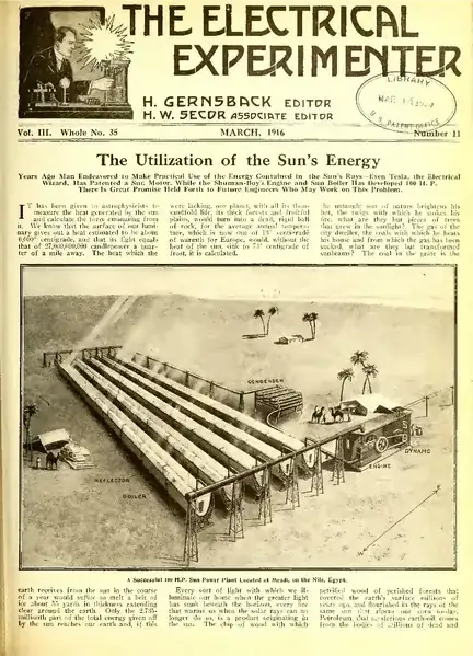

Egypt 1912
Frank Shuman's design
It actually happened:
Shuman built the world’s first solar thermal power station in Maadi, Egypt (1912-1913). Shuman’s plant used parabolic troughs to power a 60-70 horsepower engine that pumped 6,000 gallons of water per minute from the Nile River to adjacent cotton fields. His system included a number of technological improvements, including absorption plates with dual panes separated by a one-inch air space. Although the outbreak of World War I and the discovery of cheap oil in the 1930s discouraged the advancement of solar energy, Shuman’s vision and basic design were resurrected in the 1970s with a new wave of interest in solar thermal energy
https://en.wikipedia.org/wiki/Frank_Shuman

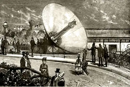

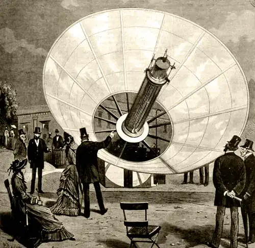

A Frenchman named Augustan Mouchot demonstrated solar powered steam engines in 1866.
Augustin Mouchot taught secondary school mathematics from 1852-1871, during which time he embarked on a series of experiments in the conversion of solar energy into useful work. His proof-of-concept designs were so successful that he obtained support from the French government to pursue the research full-time. His work was inspired and informed by that of Horace-Bénédict de Saussure (who had constructed the first successful solar oven in 1767) and Claude Pouillet (who invented the Pyrheliometer in 1838).
Augustin Mouchot’s Solar Concentrator at the Universal Exhibition in Paris, 1878. (source)
Mouchot worked on his most ambitious device in the sunny conditions of French Algeria and brought it back for demonstration at the Universal Exhibition in Paris of 1878. There he won the Gold Medal, impressing the judges with the production of ice from the power of the sun.
Sadly for the inventor, coal was and is far cheaper especially since it can be burned 24/7 for power when you need it.
