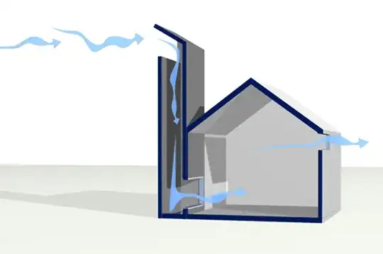

You Need a Windcatcher House
Windcatcher House
Sheets of glass for the most part is not a great building material. Glass in the form of bricks can be structural, which will allow you to build up. You could build a glass house and yes, it would get hot in the desert. But proper desert homes don't get hot. Instead of building a house with four walls and a pitched roof, you just need to incorporate a few features to make your desert home comfortable.
A windcatcher, also known as a malqaf, is a tower higher than the rest of the structure which has a shaft that leads from the tower to the living facility. The open face faces the prevailing wind, which catches it and pulls it down the tower, which cools your glass structure. The windcatcher does not necessarily cool the air itself, but rather relies on the rate of airflow to provide a cooling effect. They have been used in desert climates for thousands of years.
How about Making Ice?
You might find that this structure cools your home, but you want an extra blast of cooling for water storage, food storage or making ice, using only the wind. What you need to do is add another tower which faces the opposite direction of the prevailing wind. With this tower, the wind is drawn upward using the Coandă effect.
It's more effective with a basement and if your settlement is feeling industrious, an underground water channel with holes spaced along the length of the channel to the basement of each home. The ancient Persians called this channel a qanat.
Yakhchāl
This combination of design elements will keep your desert homes much more manageable and energy efficient because you're not spending resources on active cooling. It's passive and it works.

  • I would imagine the air being cooled by the qanat's would cause excessive evaporation. Depending on the quantity the water source could provide, I am not sure a desert dwelling city would want to waste excessive amounts of water to cool the buildings. – sonvar Jan 22 '19 at 02:00
    @sonvar and yet they have been in operation since 3,000 BC and nobody has criticized evaporation. I didn't state it in my answer, but you can control the wind, the air and the exhaust by limiting the size of the orifice, the same way you can control water flowing through a valve to suit your needs. This is proven technology. – gwally Jan 22 '19 at 03:54
    What kind of outside air & underground temperatures are required to actually create ice? The two wikipedia articles only mention creating ice in "winter", but what temperature is that? – Xen2050 Jan 23 '19 at 00:58
  • The average temperature during the summer around Isfahan, Iran in June is 95° F | 55° F. With a 10 mph constant wind, you get a wind chill of 5°F with no pressure drop. With a pressure drop, you can lower the temperature by 20° F. If the basement is already 40° F, it should be no problem keeping things cold. The formula for Boyles law is PV=k. Someone feel free to clear up my math. Every time I try it, I get -330° F, which is not correct. – gwally Jan 23 '19 at 02:44
    Working on a moderate-desert-based game, and this style of architecture/engineering came up in my research. It's always good to see how real-world people solved these problems that seem so "fanciful". – MandisaW Jan 23 '19 at 17:44
  • @gwally - So, wind chill wouldn't actually lower the temperature, it just moves hot air. It's not very good for freezing things (although it can speed up freezing if you already have cold enough air). There is a possible effect with wind accelerating evaporative cooling of liquids, but you can't directly plug wind chill numbers into that formula, and the maximum temperature drop is more modest. The other issue is that the ideal gas law, and any specifications such as Boyle's law, only work with absolute temperature scales such as Kelvin, which might account for the issues with your math. – Obie 2.0 Jan 24 '19 at 10:05
  • @gwally For your computations, the full gas law is actually PV = kNT, where N is amount of air (number of molecules), T is the temperature in Kelvin (not Fahrenheit). – fishinear Jan 24 '19 at 17:17
  • @fishinear If you want to post an example answer using the weather stats for Isfahan, I would be really grateful. – gwally Jan 24 '19 at 18:23
  • @gwally I don't know how you did your calculations, and don't know what equipment you were thinking of using, so cannot give an example answer. With equipment as shown in this answer, you cannot get lower temperature than the temperature of the water underground. The wind-chill effect only speed up the cooling of your skin by removing the warmer air that surrounds your body. It will never lower the temperature to below that of the air. If the temperature of the air is higher than your skin temperature, wind chill will actually warm you up faster. – fishinear Jan 25 '19 at 19:12
  • @fishinear And yet it has worked for thousands of years. When you let gas out of a cylinder, the cylinder cools. This is called Adiabatic cooling and why my propane tanks frost after heavy use. When you compress a gas, the temperature rises. This concept his how a diesel engine works. Adiabatic cooling occurs in the Earth's atmosphere when the pressure drops, as illustrated in the diagram of my answer. What I am having trouble expressing is how many moles are in 1 bar of air so I can correctly calculate Boyles Law (PV = k). – gwally Jan 25 '19 at 19:37
  • When I mentioned wind chill, I missed adding "feels like" when mentioning a 5° drop in temperature. Pressure drop on the other hand is a real phenomenon, which is why a Yakhchāl works in the first place. – gwally Jan 25 '19 at 19:41
  • @gwally Adiabatic cooling is used in pretty much every modern cooling installation, such as your fridge. But your diagram does not show adiabatic cooling. The (small) under pressure created by the Coandă effect of the wind is only used to draw up the cool air from the water underground. The temperature will not get lower than that of that air. That can still be a lot lower than the outside air temperature, of course. – fishinear Jan 26 '19 at 12:34
