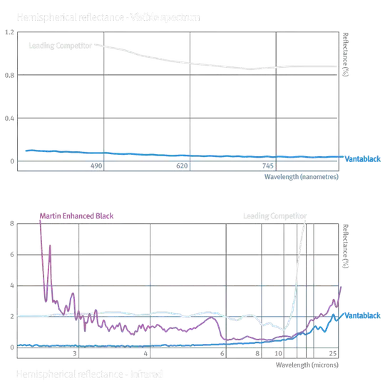

No, it is probably terrible stealth.
A simple google search yields good results, such as this site with a picture of the reflectance.
We're talking about 2% reflectance, and increasing, for radio waves of wavelength of 25 microns and greater. A stupid crude simple radar could detect that (if close enough). If we are talking about big distances, possibly a powerful enough radar could do the trick.
See also this answer.
To deal with the comments: What if the ship is far away?
Assume a radar that shoots an EM wave with a power $P_0$. Assume our radar has a maximum detecting distance of $x$. This is equivalent of saying that, our radar can can detect a receiving EM wave with minimum power of: $$ P_1 \approx P_0\frac{1}{x^2}\frac{1}{x^2} = P_0\frac{1}{x^4} $$
This takes in consideration a hull of reflectance $100\%$. If, our reflectance is, instead, a number $R$, then, the new minimum detecting distance $r$ is: $$ P_1 \approx P_0\frac{1}{r^2}\frac{R}{r^2} = P_0\frac{R}{r^4} $$
Because $P_1 = P_1$, we can relate $r$, $x$ and $R$: $$ P_1 = P_0\frac{R}{r^4} = P_0\frac{1}{x^4} \quad\implies\quad \frac{r}{x} = R^{\frac{1}{4}} $$
For $R=2\%$ we have $r/x \approx 37.6\%$. Thus, the maximum detection distance would now be $37\%$ the initial one. So, if we acquire a radar that can detect 958,000 Km maximum, it can also detect such vantablack coated ship at 360,000 Km.
If we already have a radar that can detect 360,000 Km maximum, to adapt and detect the vantablack coated ship, it would be just a matter of tripling the power (sometimes not hard to do), or tripling the sensitivity (perhaps by increasing the antenna dish by a bit less than two times the initial size).
Reflectivity: enter image description here
