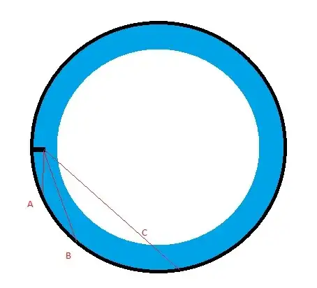

Look at the schematic below (not in scale):
ring world atmosphere
When you look at an object along line of sight B you are actually looking through a larger layer of air than when you are looking along the line of sight C.
This means that you will see the image of the ring world fading away where the optical path goes through more air and then becoming sharper.

    I think you misunderstood the question maybe? Obviously light from the ringworld far away can reach you but I suspect the apparent size would be much much smaller than the one shown in the pictures – SilverCookies Dec 07 '18 at 14:06
  • Very interesting that with the proper tools, you can see distant regions more clearly than relatively nearby ones. – Nuclear Hoagie Dec 07 '18 at 14:15
  • @SilverCookies, OP is not asking about apparent size – L.Dutch Dec 07 '18 at 14:26
  • @L.Dutch I interpreted the question as if it meant if it was possible to see the ringworld curving upward using only one's sight, not with instuments – SilverCookies Dec 07 '18 at 14:56
    @SilverCookies, but since OP is not setting the width of the ring, it cannot be excluded that is visible as a whole with the naked eye – L.Dutch Dec 07 '18 at 15:02
