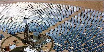

Well we can theorically fill the moon surface with mirrors (well the ~50% of visible moon at least), directed toward Earth and with a slightly parabolic surface in order that each single mirror can focus the light on a particular point of the Earth. If every mirror can alter its orientation according to moon phase then we will have a varying amount of energy to be used on a single point (that can in example use a steam tank to convert the Moon-laser into kinetic energy)..
Looks actually more like a weapon than anything really usefull, and as side effect moon will no longer be visible clearly because now instead of reflecting light in each direction is reflecting light only in a specific point of the Earth surface.
The working principle is like current solar plants, but instead of using a central tower, we use Earth:
I don't really know if that kind of thing would just cut the Earth in 2 or if we need to orient the mirrors towards multiple points instead of only 1, seems much more feasible than moving batteries. Apart the cost of putting there a so big number of mirrors, seems actually even a really viable solution.
Probably there will be night big events only on full moon nights (to power up stadium lights and people TVs watching the games).

1As I pointed out in the new thread: this will not work. The only thing that happens is that on 5% of the Earth's surface, you get another Sun. At that distance you cannot focus the Sun tighter than a circle of 1700 km. http://worldbuilding.stackexchange.com/a/51840/12297 – MichaelK Aug 16 '16 at 12:47
1So just build twice as many solar panels on Earth instead. Bouncing the light off the Moon first and then losing 30% in the atmosphere is just a waste of time, money and effort. Or build the solar panels on the Moon — instead of mirrors — use the energy to produce something that requires energy (like metals or fuel or fertilizers or whatever) and ship the goods to Earth. – MichaelK Aug 16 '16 at 12:58
