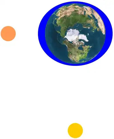

Let's start with the moon:
When the moon is at one point, gravitation laws makes that everything is slightly pulled towards it. As the water is a fluid, it moves a bit towards it, this is straightforward to understand. On the opposite side of the earth, the water also rises, this is not so trivial to understand and is well explained in this question. Basically, as the moon is very far away from the water on the other side of the earth, it's attracting it less, so the water rises.
In my picture, the high tide would be roughly in the middle of the Pacific and in the western coast of Africa.
Now let's rotate the moon (or, rather, the earth)
Well, this is easy to follow, the high water follows the moon. If you stay at one point close to water, you will see it rise and recess (twice a day) as the upper water us followed by lower water, and then by higher water again, and so on.
Now, in the illustration, high tide would be roughly in India and in Mexico.
In this sunless system, the amplitude would always be the same between high and low tide.

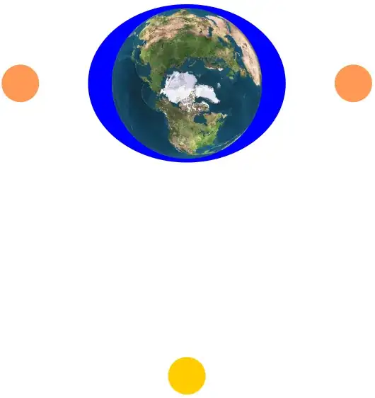

Now, your case
You have two moons, opposite to each other:
The water is pulled twice as much as on earth towards space below the moons.
But your moons and your planet are tidally locked, so the water is always high at the same place, and always low at the same place. In other words, at a given beach, the water is always at the same height. Hence there is no tide due to the moons.
Enter the local star
I understand that your planet is not tidally locked to its star. So:
The sun will create a tide, just like on earth. Assuming the same star size and distance as on earth, the amplitude would be much smaller (roughly about a quarter of what's on earth). This is because the sun is the only object inducing a tide, and it's influence is reduced in comparison to earth, because the sum of the moons' masses is heavier.
