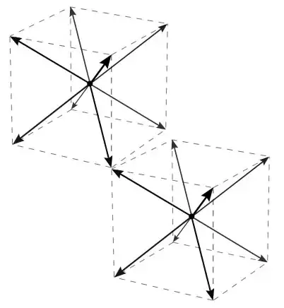

Objects can basically only move at a certain constant speed, and only in one of eight special directions, $(\pm 1, \pm 1, \pm 1)$ in Cartesian coordinates.

Newton's second law $\mathbf{F} = \dfrac{d\mathbf{p}}{dt}$ still holds, so heuristically, for a generic set of particles at generic positions under the action of generic forces, the probability that the momenta have one or more components nearly equal to zero will be very small. Since $\lambda$ is very big, the components of the velocity vector will generically be close to $$v_i = \pm \left\vert\dfrac{p_i c}{E}\right\vert^{1/(\lambda-1)}\: c \approx \pm \left\vert\dfrac{p_i c}{E}\right\vert^0\: c = \pm c,$$ as I claimed in the summary.1 This implies, among other things, that it is virtually impossible for any object to stay still: its velocity will generically be one of the eight possible vectors pictured below (which one depends on which octant the momentum vector lies).

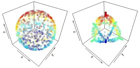

EDIT: Inspired by Aric's answer I tried to make a simulation myself. I'm not very good at coding so I haven't been able to make the inelastic collisions work yet. Applying the force of gravity only, it turns out that an initially static cloud of material does seem to collapse into an octahedral shape, as suggested by some of the answers. Here are the results for a spherical slice of primordial material (color represents height):
However, since there are some points where particles tend to clump together heavily and the simulation doesn't take into account the cohesive force that would separate them, I think there's still a good chance that the real shape is more cube-like, or perhaps something in between similar to this, as suggested by JBH's answer. There's still the question of stability, that I don't know how to tackle.
