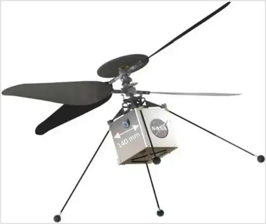

But Helicopters Would be Better Since helicopters generate lift based on the RPM of their rotors it would use a lot less energy to have say, an electric helicopter with rotors that are designed to scoop into as much of the thin atmosphere as possible at very high RPM. The real trick is keeping the RPM of the rotors high without the tips of the rotors breaking the sound barrier. Additionally, the engineering challenge of having rotors move at higher RPM is a lot lower than having to boost up to mach 4 just to be able to get enough compression in the intake to not need to be burning on-board oxygen. On Mars a helicopter would be a lot more efficient of a flyer than a plane.
NASA Is Already Building One
All the above is why NASA's next Mar's Rover is supposedly going to be an electrically powered helicopter drone.
Here's some links to NASA talking about it.
https://www.nasa.gov/press-release/mars-helicopter-to-fly-on-nasa-s-next-red-planet-rover-mission

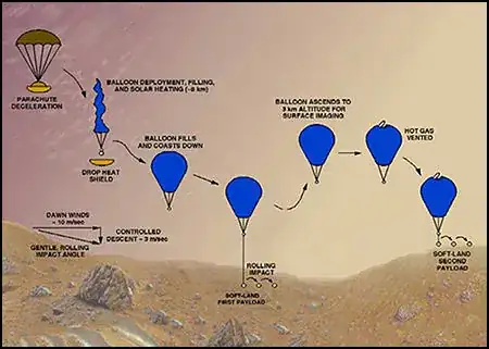

NASA has done much research on airships on Mars
Planes on mars are very difficult to use because of the low air pressure. However, airships have gotten quite a bit of attention from NASA. NASA values them because they can cover much more ground than a rover could, and a similar reason would justify their military use, even if just for reconnaissance.
Here is 2017 plan for a vacuum filled airship to float on Mars. Here are plans for a lightweight, space dropped Solar Montgolfiere baloon (pictured below).
