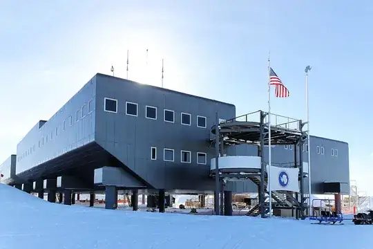

Many people talk about building the platform on legs or pylons to keep level on shifting ice and move if required, but the much larger danger for a surface platform on Europa is you are in the insanely dangerous radiation belts of Jupiter, and will receive a lethal dose rather quickly. Even electronic machinery will be effected by the radiation.
Amundsen–Scott South Pole Station
You will need a massive amount of shielding, for example melting water and filling a dome over the station with a shield at least 5 metres thick. Burrowing into the ice is also an alternative, minimum depth would be 5 metres, but the ice sheets are thought to be kilometres thick, so you can go down a considerable distance, or even into the ocean itself.
Europa
Careful observation of the surface before landing and drilling operations are conducted should;d identify large and stable ice sheets. The networks of lines on the surface ice may indicate the places where the ice sheets meet, and should be avoided.
So a surface platform is likely not the best solution for working on Europa.
