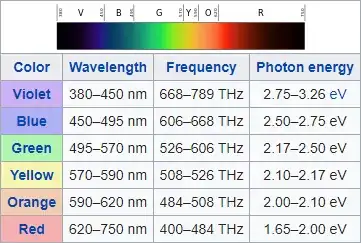

  • Regardless of how they are wired, for most light sources, bluer light is more efficient to produce on a per-lumen basis. I believe this is due to how eyes perceive light. Look up the same model of LED bulb in different colour temperatures, for example. – SomeoneSomewhereSupportsMonica Jul 24 '18 at 08:20

Color - majority white. Then, other colours.
This is much more difficult to answer.
If you are talking about energy consumption:
It must be red.
If you are talking about psychology you could read this investigation of 134 pages... I won't do that so I've looked at other places.
I'm quite sure someone will disagree with this description about colours, but this was my best attempt searching over the internet:
  • Red: Increase heart beating rate, blood pressure and breathing rate, muscular tension, excitation, and desire, even hunger. It can increase aggressive reactions and comfort.
  • Orange: Increase recreation, mobility, vitality. Estimule breathing and relax. May increase hunger.
  • Yellow: Increase happiness and mood. Increase sight, mental activity, creativity and metabolism. Too much yellow can anger people easily.
  • Green: Its sedative and help to sleep calmly. Decrease blood pressure, beating heart rate and stress.
  • Blue: Decrease impulsivity. Make you more calm, quiet, peaceful and help to wake up. Increase blood pressure, reduce hearting rate and body temperature, and give you a tonic effect. This colour could increase productivity in workplaces.
  • Purple: Increase resistance on muscles and tissues. Decrease sadness and fear but its a melancholic colour (and ambiguous).
  • White: Increase happiness, clarity and produce a cleanness feeling. Also, make places more widen and luminous but also cold and alone.
