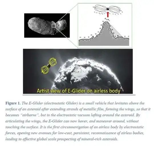

Check out this "Planet Walkers" scheme.
The Planet Walkers - Feasibility
The problem with having your little asteroids have gravity adequate to hold a player is that they wouldn't. But they definitely could accumulate electrical charge from bumping and grinding on each other and that charge could hold the player. Charges could attract or repel through a vacuum causing the asteroids to jiggle relative to each other. Your asteroid-hopping player could have an "e-flyer" which I took across from the linked idea.
electrostatic flyer https://www.nasa.gov/feature/e-glider-active-electrostatic-flight-for-airless-body-exploration
Maybe you could turn your charge intensity up or down according to how far you want to hop. Some asteroids might have a lot of charge and behave unpredictably when approached - save those for the upper levels.
