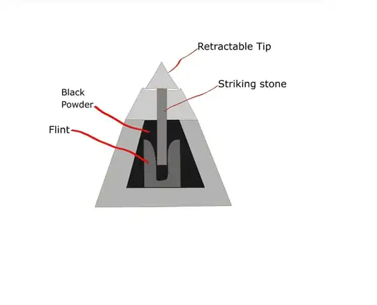

An Engineer of your stone-age tribe sat down one day with a quiver of arrows.
He knew that the black powder the alchemists created was a powerful weapon and that if he could figure out how to imbue that power into his arrows, his tribe would become one of the most powerful in the region.
Hollowing out several of the arrowheads, he realized that they could easily be filled with black powder and then re-sealed, but how to set them off once they reached their target?
Stumped, the Engineer placed down his arrow prototypes and pulled out his pouch of tobacco and pipe. Maybe a quick smoke would bring him inspiration.
Fishing the pieces of flint and stone (The alchemists of the tribe called the stone "Pyrite") from a pocket in his tobacco pouch, he sat back and struck them together to light his pipe, watching the sparks ignite the tobacco.
That's it the Engineer thought to himself. A bit of complicated stone carving will be necessary, but it will be worth the effort.
For several days the Engineer sequestered himself working on designs before he emerged with his completed arrow.
This is the arrowhead schematic he showed to his War Chiefs to explain how it worked:
The Arrowheads are built with a hollow chamber at the base. Inside this hollow chamber is a flint and striking stone "piston".
The rest of the space is filled with black powder.
The tip of the arrow is attached to the "rod" of the piston and is built to be retractable upon forceful impact.
When the arrow collides with its target, the arrowhead is pushed down, scraping the striking stone piston against the flint. This gives off sparks which then ignites the black powder, causing the entire arrowhead to explode.
The tribe would not need to know anything about blacksmithing or metallurgy, just that the rocks that look like this work for making a spark.

Something along these lines was going to be my answer. What if the gunpowder filled arrowhead was made of flint? As soon as it strikes a hard object it sparks thus igniting the powder. – Len Jun 11 '18 at 18:47
2@len Apparently what makes the spark is the shavings off of the steel, so I don't think hitting anything hard would cause a spark. Not sure though. – Schrodinger'sStat Jun 11 '18 at 18:55
1I was thinking this too, some sort of flint and steel arrowhead. This specific design may be a bit complicated for a stone age tribe but something in this vein makes sense. – James Jun 11 '18 at 21:44
1@james Agreed on that it’s a bit complex for stone-age, but given they figured out gunpowder, this isn’t a stretch. – Schrodinger'sStat Jun 11 '18 at 21:52

6One big problem with this is safety. Your quiver better not be shaky. I think the addition of a safety pin (wooden stick) would be nice to fixate the head in place and prevent accidental detonation. – Hawker65 Jun 12 '18 at 15:45
You could also carve the outside of the arrow like quadrants to have more shrapnel but this might hurt the aerodynamics too much – Hawker65 Jun 12 '18 at 15:47
how tall and heavy you want your arrowheads to carry an ammount of powder for a good explosion? Arrowhead weights are around 18 gramms. The powder charge would be at least a magnitude larger, making these super unwieldly if placed at the tip. – Trish Jun 13 '18 at 12:02
1Design is good and will work but there's a complexity to it which makes it dangerous. The arrow can be set off during release. The arrowhead is brought to maximal velocity during a short power stroke of around 21-24 inches and within a fraction of a second. The draw weight actually perfectly sets the lower bound for how high the static friction has to be at the very least. If your bow has 100 lbs of draw weight then push on the arrow with a 100 lbs force and see if that can overcome static friction and collapse the arrow head. Make it double! Require 200 lbs to activate the arrowhead. – Marc R Oct 12 '23 at 09:47

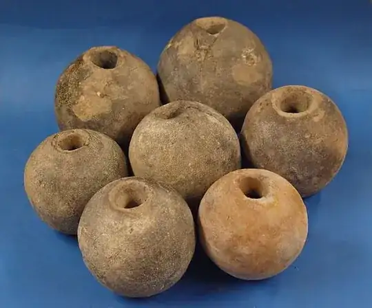

Step 1: Grenades
But they have clay! They can shape easily small pots and burn them, then fill them with their gunpowder. Cap with something and add a fuse, ready. But that is a rather heavy item. The Chinese had them called 震天雷, "Sky-shaking Thunder", we call them hand grenades. It looks like this (in the middle):

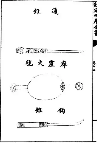

Or these:
One could easily envision to add a loop to that design, put a piece of rope through the loop and then sling it, again, using a fuse.
Their lack of cast iron makes them unable to make flying-cloud thunderclap cannon" (飛雲霹靂炮; feiyun pili pao) type of ammo, that relies on a specific type of gunpowder and the hollow metal shell to create sparks to ignite half a pound of powder.
