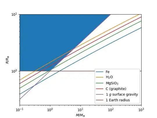

Bigger planets don't always have greater masses. Remember, mass and volume are related by $$M=\rho \frac{4}{3} \pi R^3$$ where $\rho$ is density. Make $\rho$ small enough and the gravity and be as weak as you like. So the answer to the title question is a firm "yes." I did some playing around with this based on mass-radius relations by Seager et al. 2008 and created a modified plot of mass and radius based on several different compositions:
The blue shaded region is the allowed subset of parameter space with planets satisfying $R>R_{\oplus}$ that have surface gravities less than Earth's - the properties you want. Very few terrestrial planets occupy this area, and few are primarily silicates, like Earth. Your planet is likely to have significant quantities of water and may be an ocean world.
