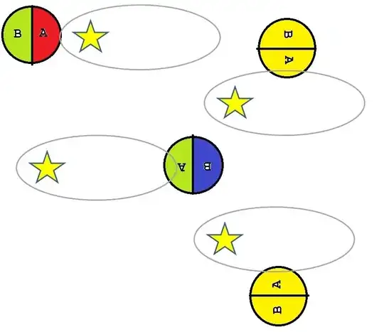

Maybe this could be done with an extremely elliptical orbit. https://en.wikipedia.org/wiki/Elliptic_orbit
Here is how I envision it.
elliptical orbit
In this planet, the day is equal to the year - the planet turns on its axis once for every trip around its star. A is always day. B is always night.
  • When A is hot the planet is close to the star, and A faces the star. It is night time on B and it is warm because of the heat delivered to A traveling over by convection.
  • When it is far from the star A does not get as hot and so it is nice there. But the night side gets very cold.

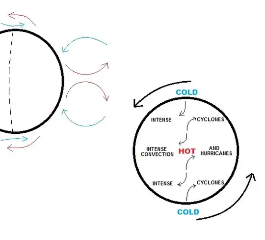

If we say that the orbit is possible, here's how the planet's general atmospheric circulation might look (first looking from the side, then from the sun's perspective):
Here, side A is shown along with the circulation and phenomena one might expect to find at different latitudes.
Ryan Clare
