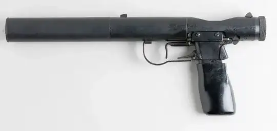

  • There was a gun used in ww2 called the welrod that was nearly silent for its first shot. Ian of forgotten weapons on youtube had a very informative video about it. Not exactly what you're looking for, but certainly relevant. – Jonathan Apr 26 '18 at 21:29

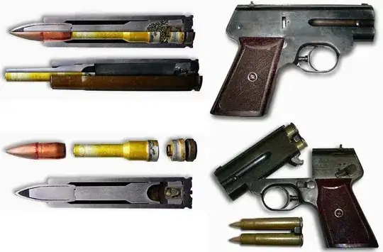

It basically already exists.
Behold, the Russian S4M pistol:
PSS Silent Pistol
This firearm, like the others in its family, uses a unique piston-driven cartridge. If you look in the cutaway cartridges, you will see this piston behind the bullet. When propelled by the gunpowder charge at the rear, the piston rams the bullet forward, propelling it down the barrel.
When it reaches the end of its stroke, the piston seals on the front of the cartridge, preventing any noise or gases from escaping. The only noise in the action comes from the internal striker system, and the mechanical friction between the bullet and barrel.
As long as the bullet is subsonic (and in this design, it is) there will be no sonic boom as it passes. While there might be some noise from the striker, at most it is a 'click' rather than the loud bark of even a suppressed and subsonic conventional round.
Use an electronic primer to eliminate the noise from the striker mechanism, and integrate suppressor baffles into the barrel to eliminate any noise produced as the bullet scrapes by, and there you have it- a completely silent firearm.

    nice. credit images please? – Willk Apr 25 '18 at 22:13
    The wikipedia page on that suggests that it is nearly useless outside of point-blank range, though the rifling makes the bullet look like it was fired from further away. – fyrepenguin Apr 25 '18 at 22:44
    There's no way this thing has the muzzle velocity to make it hurt at 200m, much less compete with a .308. – chrylis -cautiouslyoptimistic- Apr 26 '18 at 02:00
    @chrylis I was confused as to your comment, but then I saw that the question was edited to include performance characteristics after I posted this answer. This cartridge is listed as having an effective range of 25m and is capable of piercing a steel helmet at 20m. It is not a rifle round and does not on its own satisfy the updated requirements. – Catgut Apr 26 '18 at 02:12
    Does it not make a sound when the piston bangs into the case? I imagine it must sound a little like hitting your pistol with a hammer. – Daniel Apr 26 '18 at 08:47

    "The only noise in the action comes from the internal striker system, and the mechanical friction between the bullet and barrel." And whatever mechanism eventually stops the piston. – David Richerby Apr 26 '18 at 18:17
    It produces sound by all 3 methods pointed out by OP. The only thing it doesn't produce is actual gunshot. – Agent_L Apr 27 '18 at 13:06
    Youtube has a video. It's pretty quiet, still makes a "clack" though. https://www.youtube.com/watch?v=K73kKODFyzw – bobflux Apr 27 '18 at 23:15

There are already a wide variety of supressed weapons out there. Russian "Captive Piston" rounds are likely the best way to use conventional weapons (simply load 9mm captive piston bullets in a Glock, for example), so long as you make allowances for the reduced range and penetration compared to normal rounds. This isn't limited to pistols, the US Navy developed a captive piston 12 gauge shotgun shell during the Viet Nam war. The US Army also experimented with captive piston and other silenced weapons for "tunnel rats".

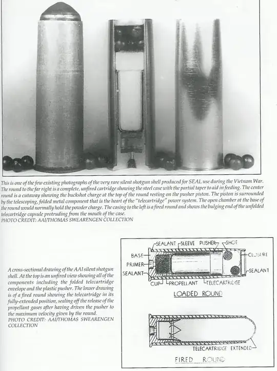

12 gauge "telecartridge"

Welrod Mk 1 pistol

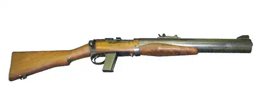

The De Lisle carbine is perhaps the most extreme example from that period, essentially turning the entire barrel into part of the suppressor:

This was far superior to the more complex suppressor of the Welrod pistol. As an aside, the carbine allows it to have an effective range of 200m, and while being shot with a.45 ACP isn't as powerful as a .308, it most certainly does the job (silent sentry takeouts, for example).
enter image description here De Lisle carabine
So the short answer is to use captive piston type ammunition if you want to use conventional firearms, or weapons with subsonic ammunition and extreme suppressors if you are willing to use specialized weapons.

  • I have shot a replica de lisle and can confirm it is bonkers quiet. We were in an indoor 25m range and the only audible sound was the clang as the 45acp round slammed into the metal backstop. 200m would be a stretch though maybe not impossible, I think we used it at 100 a couple of times. – Joseph Rogers Apr 26 '18 at 17:05
  • Owning both a 9mm carbine and a 45acp carbine, hitting something at 200 yards is almost an artillery exercise. Lots of fun though. – ivanivan Apr 26 '18 at 17:54
    The De Lisle carbine is actually supposed to be able to hit targets at up to 400m, with 200m being it's effective range. More power to those Commandos and SOE operators in WWII, and British SAS and SBS troops who supposedly continued to use it in Malaysia, Northern Ireland, Yemen and even into the Falklands Islands War. – Thucydides Apr 26 '18 at 22:15
