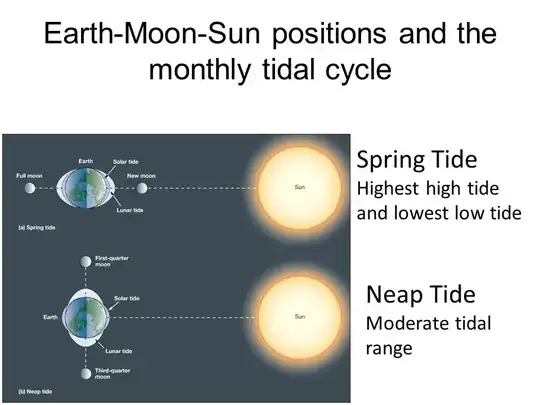

Setting apart any consideration on the long term stability of such configuration, we can look at the situation on Earth, where tides are generated by two bodies: the Moon and the Sun.
The highest tides happens when the Moon, Earth and Sun are aligned (new Moon or full Moon), while when the Moon-Earth line is perpendicular to the Sun-Earth line (first quarter and last quarter) the tides are at a minimum/
By analogy, having two moons facing each other with the planet in the middle would give higher tides than what would be with the two moons shifted by 90 degrees in the sky.
