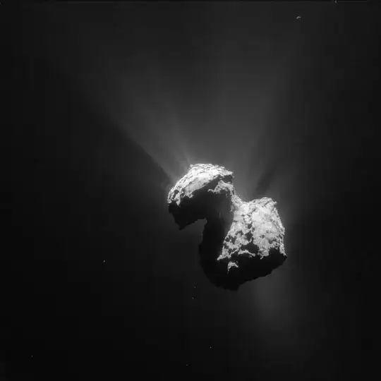

Not for a planet, but for a smaller body.
Massive bodies are in hydrostatic equilibrium. Gravity pulls them into spheres, eliminating most non-negligible variations from perfect roundness. Obviously, protrusions like mountains exist, but they're minute compared to the size of a planet.
That said, smaller bodies may not be in hydrostatic equilibrium, and this sort of object can form. 67P/Churyumov–Gerasimenko, for example, is a comet that has a barbell-shaped nucleus. You could absolutely get a minor body shaped like this.
Image from the ESA, under the Creative Commons Attribution-ShareAlike 3.0 IGO License.

Excellent real life example! thanks for letting us know about this cool comet :). I think this answer may be improved by adding its dimensions as a reference: (from wikipedia) "The comet consists of two lobes connected by a narrower neck, with the larger lobe measuring about 4.1×3.3×1.8 km (2.5×2.1×1.1 mi) and the smaller one about 2.6×2.3×1.8 km (1.6×1.4×1.1 mi)." Also, if there's a known maximum theoretical size for such an object, that'll be a great addition (in other words, this example tells us that an object roughly bounded by a 4x3x3km box is possible - what about a 10x10x10?). – G0BLiN Feb 05 '18 at 16:13
