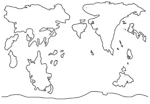

I'm having trouble figuring out the various biomes for my planet. I have extensively read the post on "Creating a realistic world map - Currents, Precipitation and Climate". But to be honest, I'm hung up on my map projection and getting the latitudes correct. My mind just can't seem to get over the hurdle that the land masses are distorted and how to correct for it. Any help would be appreciated.
your climates will be very similar to earth since the land masses are in very similar places, only the two western most islands will give you any trouble since they are no earthly equivalents. – John Jan 22 '18 at 00:21
1@John that assumes that the planet is the same size and temperature as Earth and that the oceans are the same salinity as Earth. Maybe some other assumptions. But if it is generally Earth-like, then I think John is correct. – SRM Jan 22 '18 at 05:46
1@SRM Yes I Forgot to say this assumes the planet is the same as earth is everything but land mass distribution. changes in size, inclination, atmospheric composition, or orbit will all have large effects. – John Jan 22 '18 at 15:25
@OCA@blu you may want to add what is and what is not the same as earth besides the continent position. The next step will be working out where your mountains are. – John Jan 22 '18 at 15:32

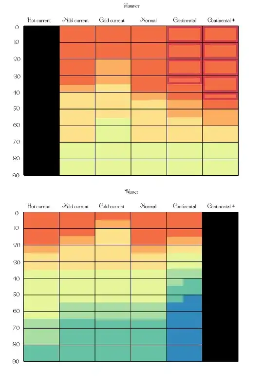

First, map out some key influences. Ocean currents (warm/neutral/cold) and continental influence are the relevant ones here; if necessary, get an extra pair of maps for these. The current influences are coastal, and affected to some degree by wind; if your wind map has air blowing over the appropriate current type (neutral is essentially a transition, typically around 45N/S, but warm currents in higher latitudes are also likely to qualify as this) onto land, draw the relevant influence a little further into the land. Continental influence tends to fall under high pressure zones in winter, or low pressure zones in the summer. If you have something like Asia, expect its continental influence to be exaggerated near the center. Also, any ice pack situations (see northern Canada and Russia) will be continental as well.

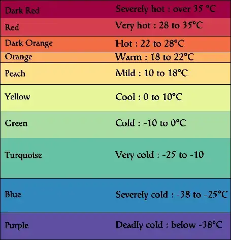

For the temperature guides, I'm relying on these images (source is in the credits):
The latitude guides are a general pointer for temperatures at a given latitude, assuming sea level; temperatures will drop roughly 6C for every 1000m of elevation, so mountains will be significantly colder. The last image is a color guide relating the colors in the latitude guides to the appropriate temperature ranges. Continental plus, essentially, is to be used in a central-Asia type of area, so it's not relevant unless you have large continents with probable ice-packs blocking the north or south.
These guides aren't exact (climates being by nature rather inexact when trying to apply what amounts to educated guesswork), so there's a fair bit of fudging involved. Coastal areas tend to have milder temperatures (warmer in winter, cooler in summer), but this doesn't typically apply to inland seas or ice-pack conditions. If you're using the extreme edges of the scale (dark red or purple) in more than very small areas, you'll probably want to do another draft; applied to Earth, this method maps the greatest heat only to small parts of Africa and Australia, whereas the nastiest cold is only in Antarctica or Siberia, or perhaps something like Everest.
A warning here: this assume Earth conditions. Changing the axial tilt, the solar constant (essentially the relation between average orbital distance and the sun's luminosity), orbital eccentricity, albedo, and so on will have a serious impact on the latitude guide. Figuring out precisely how to adjust the latitude guide to match changes in conditions is probably a matter of educated speculation, but I'll try to give a few pointers. Adjusting the axial tilt will have a greater impact at higher latitudes; a larger tilt translates to greater extremes in temperatures. If solar luminosity or orbital distance changes, that will affect your planet's average temperature. In a non-trivially eccentric orbit (I would think e <= 0.03 would be trivial, but that's just my opinion), orbital distance will not remain effectively fixed, which obviously will affect temperatures and probably require you to make separate latitude guides for the north and south hemispheres as well as for the seasons; you'll also need to place perihelion and aphelion in relation to the seasons.

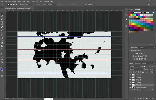

However, for your specific issue with the latitude, I'd start with plotting the equator, and then splitting both hemispheres into 3. The line made closest to the equator will represent 30 degrees (which is usually where, in an Earth-like world, hot deserts are most likely to form), and the line made closest to the poles will represent 60 degrees (where jet-streams tend to be found).
You can also then further split up each section to get more accuracy over latitude - which is more important when placing where your tropics and arctic regions will be - Something that (according to one of Artifexian's Videos) can be derived from your world's axial tilt. To find the edge of the tropics, place a line at the same number as your axial tilt. to find your polar regions, take the number of your axial tilt away from 90 degrees.
Plotting all of this down should help you have a rough guide to figure out where bands of certain climate regions will form. Other aspects such as mountains & landmass size may also have an impact on where certain biomes form, but this is the first step I take whenever I try to figure out where biomes form in my own map-making, so I hope you'll find it useful.
(This was the closest image i could find which kinda shows what i describe that you should do. This is slightly different, as in i mark out the tropics and polar regions (as i never got around to putting in other indicators for this map) but never-the-less)
