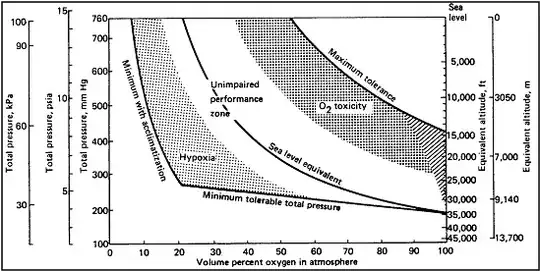

For the first part of your question, the section of the NASA Manned Systems Integration Standards on atmosphere has comprehensive information on how one would go about designing an atmosphere. It is intended for use in spacecraft but it can also apply to planets, though on a planet you would have to account for gravity as the gasses will separate by density (like oil and water).
The document covers:
- Earth's atmosphere composition
- Human performance limits, which are summarized in this chart:
The way to read this chart is to find the pressure of your atmosphere on the left axis. Then find what percent of the atmosphere (by volume) is oxygen on the bottom axis. If the intersection of those values is in the "Unimpaired performance zone" then your people will breathe normally. Above that, the oxygen is actually toxic and may cause lung damage and eventually death if the concentration is high enough. Below that there is not enough oxygen; their judgement will be impaired and they may suffocate. Note that the acceptable percentage of oxygen changes with total atmospheric pressure.
