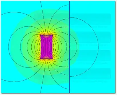

If you want to weaponize this you might be making an electromagnet. We can calculate the requirements to build it.
Here is the equation to calculate the magnetic field produced by an electromagnet: $$B = {{NI\mu}\over{L}}$$
Where $N$ is the number of turns around the core, $I$ is the current through the turns, $\mu$ is the permeability of the core, and $L$ is the flux path.
It's good that you're allowing for any level of technology, because you'll need ridiculous amounts of current, it will have to be in a superconductor. The second magic material you'll need is one with incredibly high magnetic permeability. Basically, this value defines the maximum magnetic field that the material can support. To greatly simplify it, Teslas measure magnetic flux density and materials have a maximum number of flux lines per unit area. I can't give you any ideas on what material to use, permeability changes with the magnetic field strength, it's nonlinear. We don't have data for regular materials with that high of a permeability, maybe they'll figure this out in the future.
You'll also want to have some pretty significant protection if you're trying use this as a handheld weapon. Magnetic fields aren't lasers, they are closed loops. The magnetic field this is putting off is strong enough to rip you apart. That would happen while you're levitating and your brain is filled with light and sound.
Shielding yourself from the weapon would require the same magic-core material, the one with incredibly high permeability. You can't block magnetic fields, you can only redirect them. So the shielding would be guiding the magnetic field from north to south pole on its interior. If the material is too thin or has too low of a permeability, the flux will leak out. The best current man made material saturates at about 40 Tesla. Obviously that's less than the 100 trillion that you need.

  • @Frostfyre See edits for shielding. – Samuel Feb 12 '15 at 22:44
  • @Samuel So I'm going to need a supermagnet beyond anything we've currently developed and a lot of improbibilium to construct a reusable weapon. The weapon might be better as a kind of grenade, as Linkyu mentioned, with an accompanying launcher. The grenade could then wind up the magnetism in transit, rather than storing it next to the user until needed. – Frostfyre Feb 12 '15 at 23:02
  • @Frostfyre Oh, the magnetism is generated when current is flowing, so yes don't turn it on until it's on its way. You could, of course, scale the whole thing down to less than a doomsday device. Just sayin'. – Samuel Feb 12 '15 at 23:04
