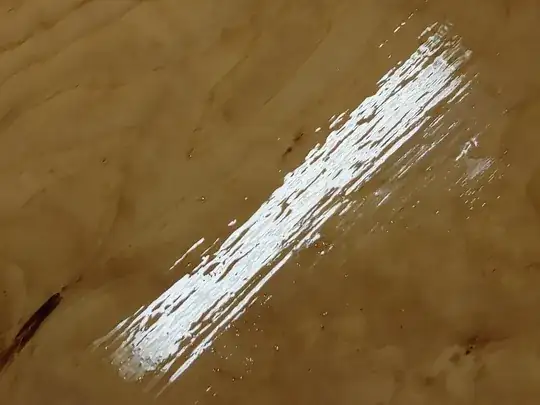

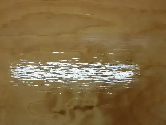

So I'm 6 coats deep and cannot get the lacquer to settle flat. I think the lacquer is just drying too fast for me to adequately put enough on before it starts to set, it's a desktop of 2 feet by 4.5 feet.
I've tried sanding between coats and even going over a new coat with thinner to make it really wet, but the bristle streaks always come through. The surface feels entirely smooth to the touch, but the streaks are real.
I've read that when people are using shellac for french finishes they move on to sanding with progressively finer sand paper with a final round of polishing. Is that what people usually do after reaching their desired number of coats or is this just totally misapplied?
What am I doing wrong here?

example of streaking via reflection another example of streaking via reflection

    Hi, welcome to StackExchange. I suspect you've done nothing wrong here per se, you just haven't done certain addition steps necessary to achieving the surface finish you want. Just to let you know now, as a rule of thumb it's rare that a finish can be applied by brush only (no other application tools used, no further steps in the finishing process) and result in a really top-class surface, even in expert hands. – Graphus Jul 10 '19 at 06:54

Before getting into the Answer proper I want to say that brushing lacquer is not an easy finish to use, any reassurances by a manufacturer notwithstanding :-) It's even more difficult to use well, i.e. to achieve a really nice result, and this goes double for large surfaces. So without realising it you set yourself a difficult task from the outset and the product's own instructions let you down (more on this below) so don't be too hard on yourself that you ran into difficulties.
This was the only outright mistake I think you made. By applying lacquer thinner to the previous, dry, surface you softened it thereby ensuring partially-dissolved lacquer would be picked up by the brush loaded with fresh lacquer.
This is the sort of thing that inevitably leads to texture problems1.
