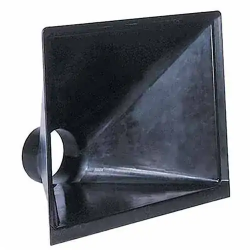

However, I do have one possible recommendation if you have a dust collector and the willingness to set this up. There is a dust hood (this one is 13" x 16")
You can set one of these behind the saw and it should catch a much larger % of sawdust from the miter. It can cover an area and the saw will be sending most of the dust right at the hood. I have two of these, one for my lathe and another where I use my belt sander.
