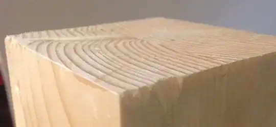

I would like to make a table leg's bottom face flat and square with the sides, using handtools.
I have drawn my knife line around the four faces for my desired length, and then proceeded to handsaw as close to my line as my skill level would allow, keeping a safety margin.
The bottom face's area (2.75" x 2.75") is too large to use with a handplane shooting board, so I've resorted to sanding with a block, but the sanding tends to eat away at the edges faster than the center, resulting in a slighly round bottom.
I'm wondering if it's one of those things which is solved with more sawing skill, or just a trip to the circular saw bench (which I don't have access to).
beefy table leg High res link
