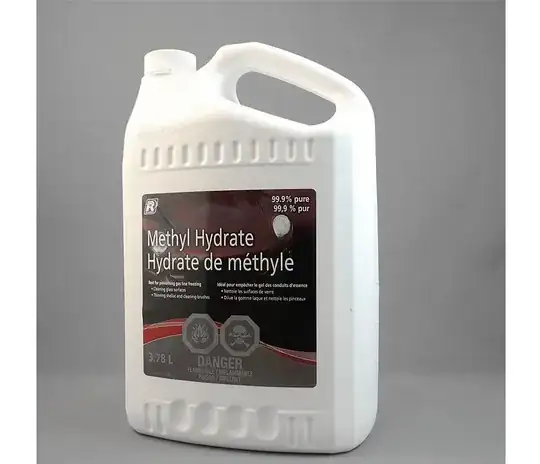

bottle of methyl hydrate
In the particular case of the product I used, "Methyl Hydrate", there are no ingredients listed on the back label. The front mentions "99.9%" pure. Pure of what? Just methanol, or pure mix of 99.9% ethanol with methanol? The fluid from this bottle is transparent. I've seen purple ones too in videos, but maybe they were denatured alcohol.
