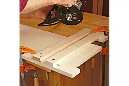

My experience is that 'tap tight' is about perfect. It should take a light tap with your hand or a wooden mallet to drive the board fast into the dado when dry fitting. Since you specifically mentioned plywood and a router, the easiest way to get a precise fit is to make a jig that is exactly the width of your boards, and use it with a top bearing (mortising) bit. enter image description here enter image description here
This is nice because it works for any width of dado.
