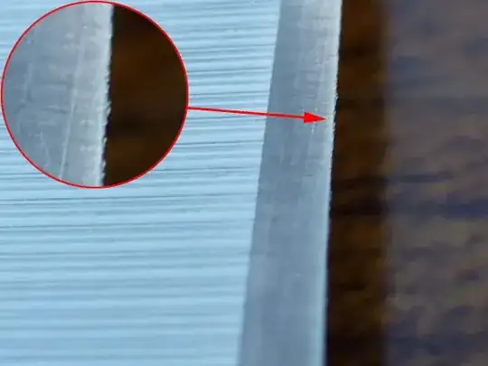

Factory sharpened
As delivered, as sharpened (well, "sharpened") in the Thai sweat shop factory. I would guess this is maybe 600-grit.
Believe it or not, you can actually cut with this, and it isn't all bad either, at least for vegetables and such.
However, I wouldn't want to use a wood tool that has an edge like this.

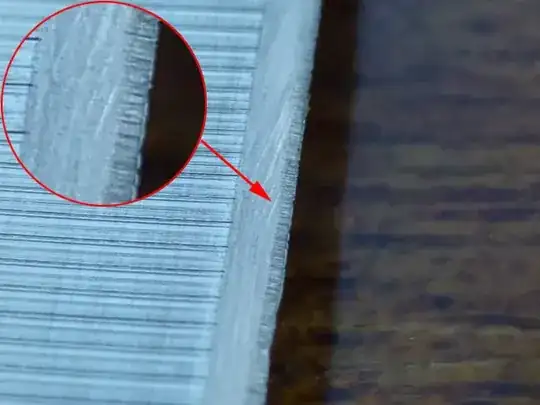

1000, followed by 3000-grit
This is after sharpening with 1000-grain, followed by 3000-grain. The edge looks already pretty nice overall, although you can still see irregularities.
