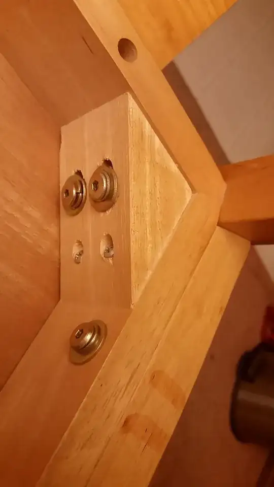

The front chair legs are mounted with hanger bolts, and they are continuously coming loose. (See pictures below.) I don't think this is a typical use for hanger bolts - from what I've researched, they're usually used vertically inside round legs, which allows them to spin tight.
I keep tightening these durn bolts, and they just keep backing out. I believe the wood threads spin out of the leg enough that the lock washer doesn't do anything and then the nut just spins off. Unfortunately there are no cross-braces, so it doesn't take more than a few days of a 4-year old wiggling before the chair legs are loose again.
I'm thinking about replacing the lock washer and nut with lock nuts, or just replace the whole mess with a large wood screw, but not sure if there is a better way to get these chair legs to stay put.
Interestingly, the TABLE legs are attached the exact same way, but I haven't had any problems with them - probably because the table doesn't get moved around like the chairs do.
Any suggestions on how to best get these chair legs to stay firmly attached?
Chair leg structure: enter image description here
Hanger bolt: enter image description here
Front of wood brace: (I didn't realize until after uploading this picture that this one is in pretty sorry condition with two of the screws probably not doing much - the rest are in much better shape) enter image description here
The back legs of the chair (haven't had any problems with this setup): enter image description here

I would replace this corner block with a new one made from knot-free wood of a strong species.
Because the wood has broken away around the lower screws it is no longer able to keep the joint rigid.
The bolts are long enough that you could make a larger (thicker) corner block that would be stronger and less prone to having the ends torn off around the screws. In the existing block those screws seem too near the edge/end.
I would also consider replacing the screws with glued dowels. An arrangement that failed before may fail again.
