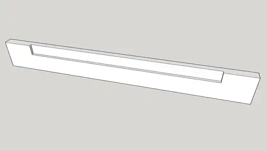

I need to cut a 2" x 1/2" lap in the middle of a 2x6 (5-1/2" on either end will NOT be cut...only the middle 3 feet). Without a router or router table, what is the best way to accomplish this?
Something like this:enter image description here

  • I'm not understanding the dimensions of the board, nor the size of the lap that is being cut. Can you clarify? Even a rudimentary drawing would help. – Katie Kilian Jan 20 '17 at 05:32
  • @CharlieKilian I had difficulty too! It's a notch 3 feet long in the edge of 2" thick material, 1/2" deep. – Graphus Jan 20 '17 at 08:01
  • Still need a sketch; not visualizing anything I'd call a lap... – keshlam Jan 21 '17 at 15:10
  • @AstPace We sure about that Sketchup image? That's exactly what I was visualising first! Then I re-read it and thought something completely different. – Graphus Jan 24 '17 at 07:21
  • You could clamp the board down flat on your bench, then cut a series of parallel shallow cuts with your circular saw almost up to the ends of the "lap." Chiseling out the waste at that point is fairly trivial. Square up the ends with a chisel, as well. (I'm new at this, but also have limited tools and have had to get creative.) – 3Dave Jan 24 '17 at 18:02
    @Graphus Lacking any feedback from OP, I figure that this diagram gives us all the same problem to solve. And IMHO it is exactly what was described.:) – Ast Pace Jan 24 '17 at 19:10
