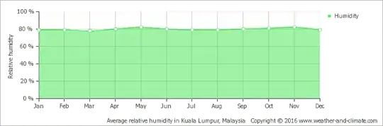

I am relatively new to woodworking. I am in the process of laminating plywood (which will be used as a tabletop and also to hide the actual support for the table). I have googled alot and found different answers. Some are not even for plywood.My question is do I need to laminate both sides?
The cost and time will be high if I do laminate.. Some parts of the plywood will be sealed to the wall so that will be useless to laminate. Can I get away with laminating one side and just coating the other side with varnish or something else (please recommend me).
The humidity here is almost constant,

  • Painting one side will not prevent moisture penetration and curling. Moisture is tenacious and will find a way in generating stress in the panel. The edges of the panel will be especially vulnerable to admitting moisture. However, the steady humidity in your chart is a good thing and will help.
