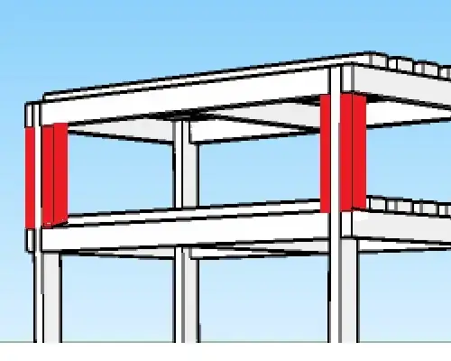

The weakest part of the design is how your substantial load is being carried to the uprights. There's not that much you can do for those joints as drawn...
I'd suggest you add actual 1x2 members beside your existing uprights that will carry the weight of the frame (perimeter) of each shelf. It's easy to build this way, and will look a little less spindly. (Comment back if you need a drawing.)
Comments above about cross-bracing to prevent racking should be taken seriously, unless you're attaching securely to a wall.
edit to add a terrible picture. (Hope you get the idea, though.)
The red parts (done all the way down, of course) will transfer load from the shelves to the floor.
One more edit:
  • glue and mechanically fasten (screw or nail) the additional uprights for strength.
  • if you start from the ground and work your way up, all you have to do is cut the additional uprights exactly the same length and the unit almost builds itself. (Exact length is easy on a chopsaw where you can gang cut everything; a bit harder with a handsaw.)
  • a cheap and cheerful crossbrace can be found at your local Ikea: http://www.ikea.com/us/en/catalog/products/87749600/ ("OBSERVATÖR Cross-brace, galvanized", $5). This would keep the back of the unit from racking, and the sides would take care of themselves.
