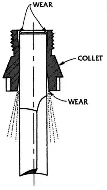

While you say the bits were cheap and you think they're to blame1 there's a good chance your collet is shot also, because once bits become loose under speed they will tend to wear the collet too as well as their own shaft. Once the collet is worn you get an effect call runout where the bit can deflect from the rotational axis. Runout causes vibration and chatter, and of course at worst the bit can work free during use.
Router runout
Source: The New Router Handbook by Patrick Spielman.
But there is a chance your collet hasn't worn excessively and just needs to be cleaned well so that it can tighten properly. Sticky wood dust and resin can build up between the fingers of the collet (even inside the hole) and it needs to be cleaned away using an appropriate solvent and small brushes.

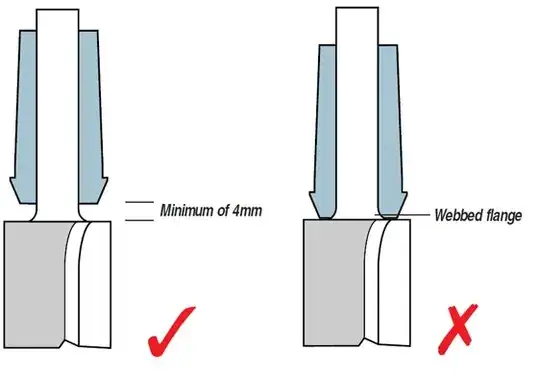

Prevention is not to be taken literally here since some wear is inevitable, but to lessen wear in future it's important to follow good practice when installing a bit2. Not sure if it's the main thing but it's important never to tighten the collet nut with a bit fully inserted or "bottomed out", always back it up slightly.
The bottom edge of the cutter head on the bit (or the bearing if it has one there) should never press against the rim of the collet, but there's also this which isn't as obvious:
Router bit installation depth
Source: Wonkee Donkey Tools.
As a quick visual reference for installing bits to their proper depth in the collet it's worth marking their shafts with a sharpie after you've determined the ideal position, the line will instantly tell you that's in far enough and not to mount the bit any deeper. This line will probably need to be renewed periodically as cleaning resin from the bit will eventually wear it away.

  • I have fixed my problem with the router. The collet was to blame. I had got a new one and then I compared the two. There was a noticeable amount of wear on the old one. I will keep in mind and try to get more one hand. (the manager of Menards took one from a new router and is going to order a new one). – Ljk2000 Oct 01 '16 at 22:44
  • @Ljk2000 When you can see the wear on the old one comparing it to a new one you know there was quite a lot. Now the thing to do is identify why the collet wore, whether it was the shanks on the bits being ever so slightly undersize or from some other cause and rectify whichever it was. – Graphus Oct 02 '16 at 07:12
