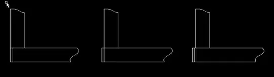

One way that I have used for this is to just use overlap corner joints for the plywood. This type of joint covers one raw edge of the plywood. On the other piece that is left with the raw edge showing I've glued on a thin strip of solid wood of the same type as the nice face of the plywood.
The thickness that works nicely for this is 1/8 inch. There are many options of how the corner is actually formed that depends just exactly what you are building. Here are some ideas of how the corner joints can be constructed to give different style looks.
