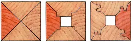

The main weakness of the pedestal as shown is the exposed end grain. This is both aesthetically less pleasing and potentially a weakness depending on what the pedestal is for (not really a problem for indoors though). So it's better to use a mitre joint of some kind:
Quadrilinear leg sections
The above image is for what's called a quadrilinear leg (intended to show quarter-sawn figure on all four faces) but obviously the same joints can be spaced apart to produce a post such as you're making.
Unfortunately the best of these, the lock-mitre joint at the right, requires a specialist router bit sized to the thickness of stock you're using.
A plain mitre joint, the option at left, doesn't glue as strongly as we'd like as it's end-grain to end-grain, but it's the simplest to produce by far and reinforced in some way it's strong enough for many applications.
Reinforcing it can be simply a matter of hammering in some nails/brads or spacing a few screws. The screw heads would obviously be very visible so if desired they can be hidden by counter-boring and using wooden plugs, which can become a decorative feature (see previous Answer).
You can achieve much the same look and nearly the same strength by drilling through the mitre and glueing in dowels. In either case, screws or through-dowelled, the mitre joint should be glued up and left to fully cure before doing any drilling.
