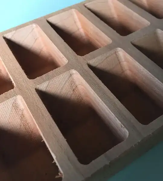

I have a sanding job that requires sanding inside many small pockets - a few thousand. I tested the speed I could get doing it by hand, and it might be as much of a week of non-stop work. It's time for power tools.
What tools are there for sanding inside small pockets, quickly? The pockets are slightly larger than 1" x 1", and 1" deep, plus a 45º slope extending out one side, for the smallest pockets. There are larger pockets in the job, also. Heck, what tools are there overall, for sanding inside pockets?
I know some people use emery boards, others use sanding sticks, some use abrasive nylon rotary tool wheels. What all options are out there?
A sample of the pockets I need to sand. Each one is a little larger than a cubic inch, and slanted on one side.

  • What are the pocket dimensions? – Matt Apr 15 '16 at 18:36
  • Slightly larger than 1" x 1", and 1" deep, plus a 45º slope extending out one side, for the smallest pockets. There are larger pockets in the job, also. – baudot Apr 15 '16 at 18:47
  • Few questions that are just for curiosity. What are you using these for? Could you line the boxes with flock? How did you make the recesses? – Matt Apr 15 '16 at 19:15
  • They were milled on a shopbot. They're for holding game tokens. The width is precise enough that to add flock lining, I'd need to remove material to make room. – baudot Apr 15 '16 at 19:19
    Have you surveyed your customers to see if there's an expectation that the pockets will be free of mill marks? I'd certainly sand all the top edges, but I'm not convinced that the interiors need that much work. – Aloysius Defenestrate Apr 17 '16 at 15:47
    If those pockets hadn't been machine made, "How do I make 1000's of pockets?" would have been the first question! – FreeMan Apr 18 '16 at 15:54
  • Aloysius - If I wasn't going to seal them, that might be an option. But they need to be smoothed enough to take linseed oil well. – baudot Apr 18 '16 at 20:21

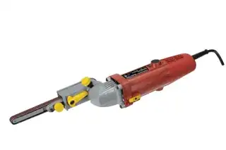

Bandfile Belt Sander
Not advocating any particular product but showing the product picture
Image from Harbour Frieght
That should help you get into the tight spots quickly and efficiently. Only issue would be the corners. For that I would use a small rotary tool. Hopefully you have one that will fit in there. Mine is a little too clunky to get into a hole that small. They make all sort of attachments for those things so a sanding ball might work just as well to conform to the shapes you have.

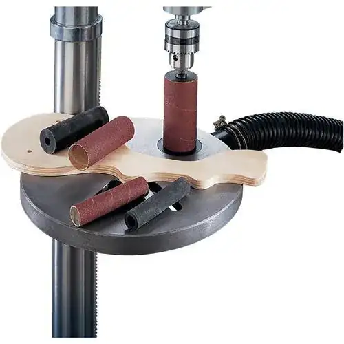

You could use a small-diameter sanding drum on the drill press, similar to that pictured below.
drum sander
(source)
You would have to lower/raise the drill press table each time you move to a different pocket, but that's not too big of a hassle.
It's hard to tell by your pictures, but the sides of the pockets look straight, so this should work for the sides.
The bottoms, however, you'll need a different solution.
