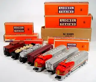

    Keep the boxes if they are original! – Raystafarian Jan 22 '16 at 19:02
  • Normally I would, but I don't think the box would have any value. It's also not a high end set, it was a Toys R Us Lionel branded train, I think the whole thing originally cost $30 (around 1980). – Bren Jan 22 '16 at 19:10
  • @Bren - you'd be surprised at what people will decide is collectible in the future and how much they might be willing to pay for it. I'd try to find some way to keep the boxes if I were you! – FreeMan Jan 26 '16 at 17:53
