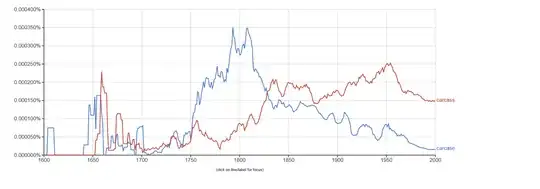

Popularity of Carcass vs Carcase, in English texts over time from Google-N gram, all definitions combined:
carcase vs carcass
