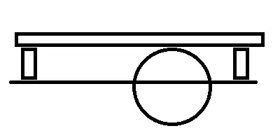

Take two pieces of wood of the height you are aiming for.
Put one at 1/4 and one at 3/4 of a distance from the blade.
Take a Very Straight Piece of scrap (extruded aluminium maybe) and lay on top of these. Put a finger on the piece closest to the blade and slowly raise the blade.
When the blade tries to raise the Very Straight Piece the lift distance is amplified in the end farthest away from the blade.

  1. Make two blocks of wood of the same height as the desired depth of the dado.
  2. Use a square to make sure they are parallel.
  3. Unplug the saw.
  4. Place the two blocks on either side of the saw blade and lay a steel rule across them.
  5. Weight the assembly by placing a weight like a peanut butter jar or something on each block.
  6. Raise the blade until it just touches the steel rule when you turn it by hand.
