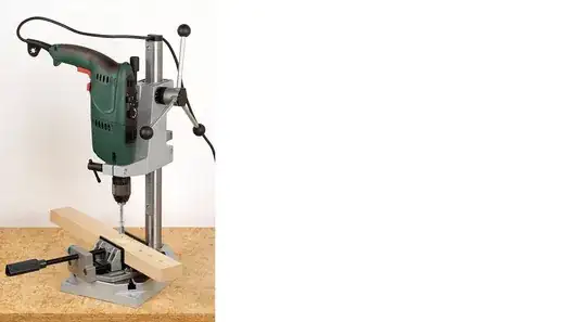

I used the router bit in the following setup and moved the work piece.
Note this picture is faked but it gives a good idea.
The problem is that the resistance was enormous and if I forced it, it just chewed the wood up. It kind of destroyed my idea of how a router should be and I don't have an opportunity to try a real router before buying.
Question
I'd still like to buy a router but I'm no longer confident that it would cut a lengthwise slot in a piece of timber such as shown in the picture.
How come the router bit didn't work in the power drill?
What is so special about a router that would make it work better?
Should it do the job smoothly, cleanly and quickly with little pressure?
Is there a lot of difference in the effectiveness of a router by price? Why?

A router spins at around 20,000 RPM. Your drill, at top speed, is closer to 300 RPM. Very different animal.

  • Simple as that then--I had no idea. 30,000 is a heck of a lot. Is it generally the case that, 'the faster the better' for a router? Are different speeds best for different types of wood? – chasly - supports Monica Oct 29 '15 at 01:09
    Some routers do have adjustable speeds, but that's more often used to compensate for varying radius of bit than type of wood. As the bit gets wider, the outed edge travels at a faster linear xpeed with the same RPM, and thst can become a kickback problem if it exceeds how willing ghe wood is to be cut. Feeding the wood more slowly can compensate to some degfee, but with wide panel-raising bits it's not uncommon tk reduce the speed by up to 50%. For the same reason wide bits are used only in a router table, not handheld -- much safer that way. – keshlam Oct 29 '15 at 02:46
    Minor pedantry: 30k seems a bit high to me. Most of the routers I've seen go up to more like 20,000. I have a Makita 1/2" router in the workshop which goes up to 22k, though this is variable. Still, you are right that it's totally different. – WhatEvil Oct 29 '15 at 08:07
    Correction accepted. Right orders of magnitude, anyway. – keshlam Oct 29 '15 at 14:24
    In addition to 10-fold higher RPM, a router will typically also have 2-3 times the power rating (and not rarely higher efficiency, which translates to even higher net power output) compared to the toy drill shown in the photo. That, plus much better bearings and thus running smoothness. – Damon Oct 29 '15 at 14:41
  • Also, routers have a flush surface which runs over the wood, or a table which the wood runs over. Drills are intended to put their energy downward through the shaft, routers are intended to have shear pressure against the bit while it turns, though the last is more in the design of the bit than the tool. – Daniel B. Oct 29 '15 at 14:46
