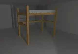

I decided to make a bunk bed for my room as it is small and I need a desk. I'm a beginner at woodworking and I need some help.
I have made some "plans", I will put 7x2m stakes, 4x1.40m each around 10cm x 10cm wide. Each horizontal stake will have a angle bracket under. Each horizontal stake next to another will a a square between.
The bed dimensions are 140x200cm.
Is spruce wood a good choice ?
How can I calculate if it supports 2 people (about 70kg each)?
Material :
My plans :
enter image description here enter image description here enter image description here enter image description here enter image description here

  • Sorry I'm having a hard time understanding your plans and material sizes – bowlturner Oct 13 '15 at 13:07
  • The wood I will use is 100x100x3000cm (or less if possible), the angle brackets I will use are 150x150x65cm. There will be two angle bracket under each horizontal wood, and one when two horizontal wood meet. Look at the last image link I put. – Servietsky Oct 13 '15 at 13:26
    @Servietsky, mm not cm in those dimensions you wrote! I'm just trying to imagine using a piece of wood 100x100x3000cm :-) – Graphus Oct 13 '15 at 13:47
  • OMG, how could I write centimeters. It's in millimeters ! – Servietsky Oct 13 '15 at 13:49
  • I made a new design in this thread http://woodworking.stackexchange.com/questions/2568/make-a-bunk-bed-v2 – Servietsky Oct 15 '15 at 16:12

  • Thank you very much ! Do you think the steel angle brackets 150x150x65cm are enough ? I made a little design update http://imgur.com/yOthh1b. Also, do you think 80x60cm wood stake would work too ? – Servietsky Oct 13 '15 at 12:15
    @Servietsky, yes those steel brackets are immensely strong. You could use them to reinforce the structure of a shed or garage so they're more than strong enough for this. "Also, do you think 80x60[mm] wood stake would work too?" do you mean instead of 100x100? Yes probably strong enough. On the verticals that size would almost certainly be fine, not certain when used horizontally. – Graphus Oct 13 '15 at 13:52

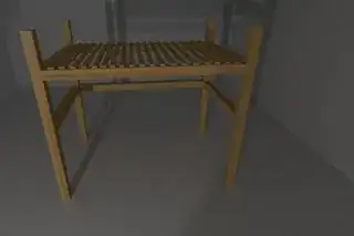

The main structural elements (the columns and the beams) are big enough to support a horse. However the slats are inadequate. The first time that you and your partner decide to occupy the center of the mattress simultaneously and apply a dynamic load you are going find yourselves and the mattress occupying the desk.
Normally a double bed would have another beam running lengthwise in the middle which should give the slats a generous amount of spring without breaking.
In addition the type of wood, sizes of wood, and the load, one must consider what is known as the end conditions of the slats. In Sagulator the default end condition (Shelf attachment) is fixed. In a fixed end condition, the end is restricted from rotation. In the case of a floating support the ends rotate when the load is applied - the extreme ends actually of the shelf lift from the support. The condition in this bed is floating. Even if the slats were to be firmly nailed to the supports, the nails would eventually loosen, same would be true of wood screws. I'm not so sure of what might happen using glue or even screwed and glued connection for the ends of the slats.
Using the floating end shelf and the 17 mm thickness specified by OP the slats are going to sag excessively (The sag is four times as much in the floating as in the fixed attachment) and quite likely could reach the point of catastrophic failure. (That's what it is called when the members actually break.)
The additional longitudinal support will solve all of the problems.

    It's not just the size of the slat material but the spacing too. Those look numerous enough to me, but obviously adding a central supporting beam is a trivial addition to the bed so well worth doing if Servietsky wants to err on the side of caution. – Graphus Oct 14 '15 at 09:57
    Valid and well worded concern! However, it seems that, as @Graphus said, there are enough slats, and from the drawings, they do look substantial. I'd recommend a trip to the Sagulator (I need to bookmark that!) to determine if the slats are sturdy enough. – FreeMan Oct 14 '15 at 20:16
    I plugged in Black Spruce, 140kg total load, 1400mm total span, 1000mm depth (10 @ 10cm wide boards), 20mm thickness. It claims that's an acceptable load. Of course, it's calculating for a static load, so you may want to err on the safe side for dynamic values. – FreeMan Oct 14 '15 at 20:21
    I assumed they'd be fixed since they're not in a rebate of the frame. I think this is a safe assumption as if they were just resting on the top edge they wouldn't need to break for a major problem to occur, they could be knocked out of position or wiggle out of position over time and eventually fall through on their own! – Graphus Oct 15 '15 at 08:53
  • @Graphus, even if nailed in place to prevent movement end to end or side to side they are still considered to be floating. The concepts of floating and fixed come from structural engineering and refer to whether the ends are restrained from bending. – Ast Pace Oct 15 '15 at 15:29
  • The Sagulator doesn't specify the nature of the fixing. Given it's primarily designed for regular folks to use for working out acceptable materials loads or spans for shelving, which are commonly fastened with nothing more than common screws (sometimes from below, not driven through) I'm pretty sure that'll be how they've designated "fixed". How exactly would a slat like this be classed as fixed by a structural engineer, by the ends being enclosed by wood, e.g. if they were terminated by M&T joints? – Graphus Oct 15 '15 at 16:41
  • @graphus, you are right, it's only special joints that can be considered as fixed in woodworking. Mortise and tenon is one, and dovetails qualify too. In steel construction a joint has to be welded in order to be considered fixed. Sagulator makes it possible for "regular folks" to determine deflections for basic beams without the need to do the math. Unfortunately, Sagulator sets the default condition to the less likely situation. Sagulator is a neat tool and like all tools, if not used correctly, can lead to disasterous results. – Ast Pace Oct 15 '15 at 18:35
