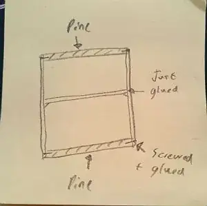

I am making a small doll's house for my daughter. This is my first project; I am a total beginner at woodworking, basically what I know is remembered from watching my dad 30 years ago :)
It's going pretty well, I have cut the panels, and even managed to get some perfect rectangles cut for windows; however when cutting them I noticed that of course, the plywood delaminates very easily - in fact much more easily that I expected.
A front view of what I was planning to do:
So I plan to make the base and main ceiling out of pine so I could screw into it for strength, however the floor was just going to be plywood glued, along with some mouldings as batons to increase the surface area along the side.
Will this design be strong enough for the interior floor just with the glue? I know that the glue is stronger than the wood; my concern is that the top layer of plywood and glue will peel off and the floor will collapse if she bangs around too much (she's two and a half).
(There will be a back as well of course.)
Matt mentioned dimensions may be important:
It will be ~22cm x 34cm x 22cm (w x h x d)
The plywood is 8mm thick; the pine is 15mm.

This would very much depend on the quality of your plywood which sounds questionable. You also don't mention the thickness which would play a role here as well. The overall dimensions of the project are not shown either. This is a dollhouse after all so I can't imagine its size would be a huge factor.
For screwing onto the base: That should be fine. If you wanted to make it stronger gluing it as well would help as well as make sure you screw into face grain and not end grain.
For the middle panel as long as you make a support for the plywood to rest on I imagine it would be fine. However you could consider making a dado (slot) for the floor to slide into.

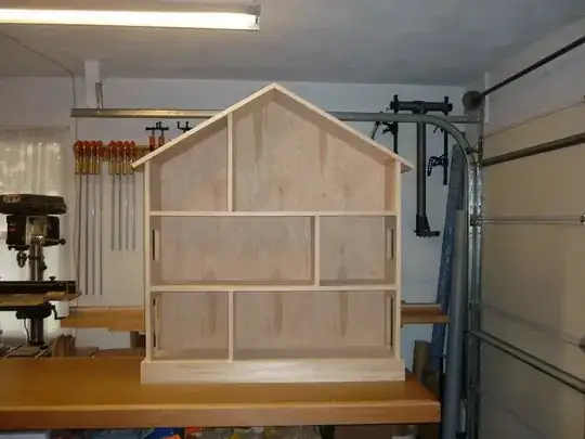

Looking at designs online I see your ideas in play. The picture below has at least the back is for sure plywood and you can see glue on the joint for the roof in the upper right. Notice the partitions on the floors that add strength in the middle of the floors. Looking at the cut windows we can see that the whole design is just plywood and it is not a stretch to assume it is just glue holding the thing together.

  • Thanks for the detailed answer (and for defining "dado" for me, I've been lurking on here for ages and not worked out what it meant yet :D) I don't have any tools capable of cutting the dados unfortunately, so they are out. I have added some details of dimensions and materials to my question, if that changes the answer at all! – Whelkaholism Sep 25 '15 at 13:07
  • @Whelkaholism While you could cut simple dados with a table saw I tried to show that your basic gluing idea should be sufficient. Provided that you use good plywood. it shouldnt be falling apart unless it had too much moisture or is of low quality. – Matt Sep 25 '15 at 13:21
    Sorry, that was unclear of me. I did get that the dados were not required. Glad to see I'm on the right track. I'll leave this open a bit longer in case of anything else that comes up, but I'm happy with this answer. On an unrelated note, I wonder if the guy who made the house in your picture intended to have no staircases and interior doors, or if he's about to kick himself... – Whelkaholism Sep 25 '15 at 13:29
Just to clarify something on this point, while this is widely said it's a little misleading. A well-made glue joint is stronger than the wood itself, but not actually the glue itself.
It's important to make the distinction because even unconsciously believing the glue is inherently strong can lead to an "it'll do" attitude to creating tight joints, which will most definitely have an impact on strength.
Note that this refers to conventional wood glues (PVA type), as well as polyurethane adhesives. Epoxies are different, and can give strong joints where the fit is loose because they have good gap-filling properties (especially if filled slightly).
Yes it should be. Even thought this is not a critical structure in terms of having to take weight I wouldn't want to trust a glued butt joint for the plywood shelf, however, glueing in the proposed mouldings underneath will add a great deal of strength.
