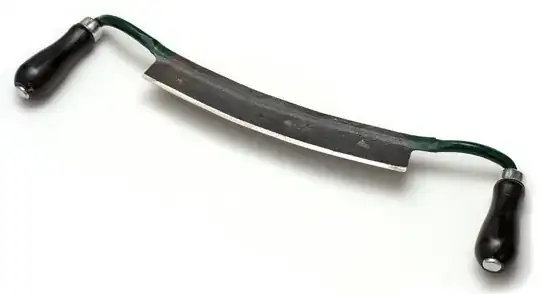

A draw knife is one traditional tool used to remove bark. draw knife at wiki
If you have a folding pocket knife, you might be able to hack it into a mini-draw-knife- wedge the tip into a small stick, use tape or twine to close up the split, then use the body of the knife as one handle, and the stick as the other.
TX Turner
  • 4,420
  • YES. I knew I brought my draw knife for a good reason. I just didn’t know if that was bad for it – Matt Aug 04 '15 at 15:46
  • If you have a magnet handy, I'd probably run it over the wood just to be sure there's no embedded nails, barbed wire, or steel buck shot in it. Oh and if the wood's green, be sure to clean, oil, and wipe off your draw knife. – TX Turner Aug 04 '15 at 15:50
    The pocket knife converted into a rudimentary drawknife is a great idea. Just a word of caution for anyone who wants to try this: from experience using wrapped two-part handles for some carving, the binding has to be wound very tightly to grip the blade firmly enough for it to be safe to use. – Graphus Aug 04 '15 at 16:10
  • @Graphus- agreed. Though the good thing is that if the tape / twine lets go, the knife just usually flips open, away from you (assuming you're using it like a typical draw knife.) I've done this a few times over the years, it's so much easier to pull than to push. – TX Turner Aug 04 '15 at 16:17
As @TXTurner suggests, a drawknife is great for bark removal. The dirt, grit, and grime in the bark will dull the blade faster, so it might be a good idea to have a drawknife dedicated for the task.

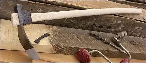

National Trails Training Partnership also suggests the following tools:
Bark/Peeling Spud
(source: TraditionalWoodworker.com)
(Carpenter) Adze
(source: Lee Valley)
I also suggest using a hatchet or small axe for bark removal. I've done this plenty of times with good results. Using a broad axe or a side axe will help speed things up since they're made for this sort of thing. Side axes only have a bevel on one side thus they are much less likely (or entirely unlikely, if properly sharpened) to bounce off the log and into your leg.
