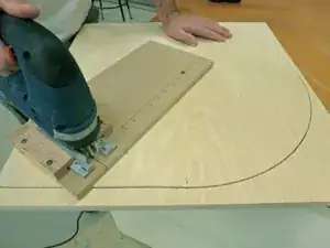

Use a super simple jig like this, 1 3/4" shouldn't be a problem at all with a decent blade.
circle jig
