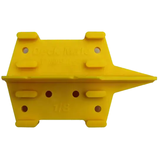

A common way to space boards when doing decking is to use one of your fasteners as a gauge. e.g., a 2" deck screw temporarily slid between the boards as you fasten the boards to the joists. You end up losing some screws that way, but it's the simplest method I've used.
There are fancy schmancy tools to do the same-- e.g.
via http://www.johnsonlevel.com/P/106/DeckMateProfessionalBoard
I doubt you'd drop this one and forget it, hehe.
(Not an endorsement, just an fyi..)
