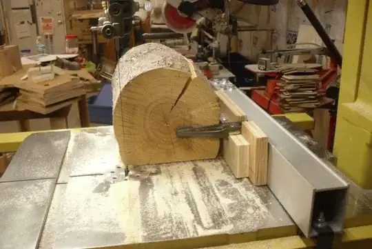

Taking a stab at "making it safer"
If you built a sled that held the log while it's pushed through the blade with handles that assured no body parts approached the blade it would be safer.
Keeping in mind that safety is not binary but a continuum.
Both of these images are sleds made for a bandsaw (as Graphus says in the comments a bandsaw is the preferred tool) but the idea is the same. enter image description here
Or this one LumberJocks.com enter image description here
Here's a rig with a circular blade.
Spacht Sawmill
The sled holding the log is huge!
