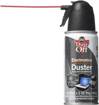

I'd imagine that canned air (commonly used for blowing the dust out of electronics) would do the trick for spot treating the wood with a freeze treatment. When held upside down, the air comes out cold enough to cause frostbite in seconds.
Canned air:
Can of air
First image found in a web search for "canned air". Courtesy of Amazon.com. Click to embiggen
Spend an hour or so in the shop or in the backyard sunshine, enjoying your beverage of choice. Keep the board in front of you and the can of air close by (do not confuse the canned air for your beverage - author not responsible for frostbitten tongues).
Every time you see one of the little buggers sticking his head out, grab the can, turn it upside down, point the straw at him and give him a spray. Even for northern bugs that hibernate over the winter, this treatment should freeze him right to death. Shake the board until his little, frozen corpse falls to the ground. If you're outside, let him be recycled into fertilizer. If you're inside, clean up according to your local shop cleanliness standards.
Alternatively, be more aggressive and simply spray into each and every tunnel.
You'll have to keep an eye on the wood for a while to ensure you got them all, whether you go for the slow, relaxing approach or the quick aggressive one.

    Uh, as satisfying as I'm sure this would be it just won't work to rid the wood of the bugs. These channels were exposed by planing, but any channel elsewhere in the wood with a live larva still resident in it almost by definition doesn't have an exit hole or any other intersection with the surface. – Graphus Dec 08 '21 at 00:09
  • oh, yeah. valid point. But it would be fun! ;) – FreeMan Dec 08 '21 at 00:33
