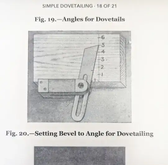

While reading "A Little Book of Woodworking Joints" I ran across this figure:
Setting Bevel to Angle for Dovetailing
The chapter on "Simple Dovetailing" has this to say about Fig. 20:
A very good method of setting the bevel is to obtain a piece of board and set up a square line as shown in Fig. 20, and mark off six units — size 1/2 in., say — and then to the left or right along the edge mark off one unit, then drawing the splay line shown, give a line so that setting a bevel to it as shown makes the inclination — or angle — of the blade with the stock 6 to 1, which is probably about the best angle for dovetailing.
To my eye, the sharp angle on the bevel makes it very easy to set the dovetail angle in this manner to a known value by using a shop standard gauge of some sort.
A square end would work, but it wouldn't be as easy to read (in my opinion) and other shapes (a reverse angle, rounded) would make this sort of the bevel-setting impossible.
    As the picture shows, though, you really don't need any particular end to set the angle... the blade has to cross the horizontal mark just as accurately as the vertical one, and there's no point there. – Caleb Nov 15 '21 at 20:51
  • As I said, the point does make it obvious and easy to read. If you want to reduce parallax errors, an acute point is better than a right angle or larger for meeting a mark. It's why pointers are pointers. –  Nov 15 '21 at 23:20
